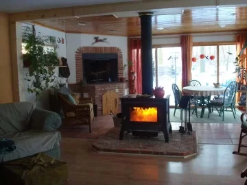

My EQ is in the middle of my family room. Will stove temps be lower than if it was in the corner or against a wall? As you can see, I have 4 doorwalls on the back side of the stove. Does this cool off my stove faster because of heat dispersement?

I think you will have more even radiation of heat from the stove. Where a wall will stop the radiation from the back of a stove normally, yours will radiate heat from the back without any issues. The doors will lower room temp, but they would do that regardless of where you placed the stove.

As a relative newbie to the whole stove experience, I have been reading about long overnight burns and stove temps between 500-600 degrees. My EQ heats this room(760 sq ft) very easily at 400-450 stove temp ( 80-85 ) room temp. It keeps the rest of the house around 75 degrees( 2900 total sq ft ). I have yet to go past 500 degrees. I am wondering if my 500 degrees in the center of the room become 600 degrees if it was in a corner or wall application ( not that I would do that)

Good News: You have positioned you stove for ideal heat transfer into your room. It can't get any better than this. You are fortunate to be able to afford such an installation. It is perfection. You will get the most heat transfered into your room for the amount of wood burnt.
Wood stoves heat a room due to radiation and convection. Radiation is the heat radiating off of the cast iron, stell, or stones of your stove just like how the sun radiates heat at the beach. You can feel this heat. It is nice and warm if you stand near the stove. Convection is the heat of the warm air around the stove. You will get convection currents that you can sometimes see where the hot air is rising away from the stove. It will cool down a bit quicker because there is nothing to trap these convection currents and the stove can radiate freely into the room. None of the radiation is being reflected back to the stove by a shield or fireplace or wall.

I don't think you can get a better install for heat radiation the you have. If the stove has heat shields on the back and side I would remove them...
