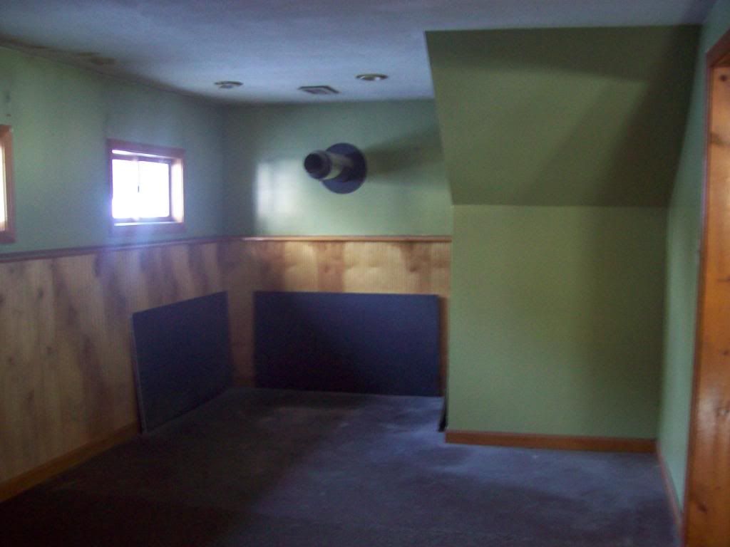

I am in the process of buying a house that I will be putting a woodstove back in. It is a split- level (4 foot basement poured walls. The stove will be in an alcove in one corner where the previous owners had one, and has an existing double walled pipe out the wall and up the side of the house.
The foundation wall is strapped and drywalled but not insulated on the inside (is poorly on the outside which will be a summer project) The previous owners had heat sheilds on the walls.
Would I be better off stripping the walls to the foundation to use the thermal mass ( slab will of course already be acting as thermal mass and a heat sink) or going with heat shields?
or should I strip the foundation, put 2 inches of foamboard in and then brick or stone the inside of that?
The stove will probably be an Englander NC 30

hmm actually looking at my photos, the area is wider then I remember... look like about 6 feet + which for a nc-30 is more then needed for combustible offset.

Looking at your picture. Is that a cold air return above the stove, or is it a hole in your ceiling to get the hot air to rise to the first floor?
it is both sortoff, house has a hot air oil system as well and that is the end of a line of duct in a t above it, so it serves as a vent to the second floor.
I will need to add some kind of outside air kit probably
Well, I can`t help you with the OAK. I don`t have any knowledge on that. That is, assuming that you really need one. The duct above your stove is an issue if it is tied into your forced air heating system. If it is pulling air from above your stove, it might not be meeting code. It has the potential to draw fumes from your stove, which you might not want.
Some greater minds on this forum will certainly comment on that issue.
dunno about the oak not sure how tight the place is. The duct above is the end of abot a 30' run from the stove, not a return, so should be fine
