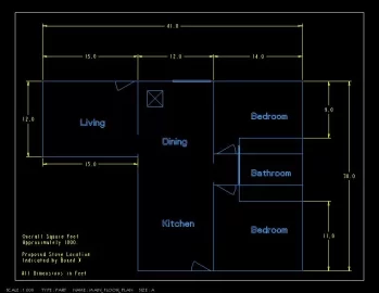

i am planning on installing a stove this coming year to be operational for the 2010-2011 heating season. I have begun to put up firewood as I know the importance of burning seasoned wood. I have attached a picture of the layout of our house. The house was built in 2003 and is very well insulated. As it is right now, we do not spend much on propane to heat the house, but I just can't stand the fact that I have wood available and it is basically going to waste. The house is right around 1000 square feet. The Living, Dining, and Kitchen all have ~14' cathedral ceilings. The bathroom and bedrooms have standard 8' tall ceilings.
My plan is to build the hearth in the corner were the boxed X is located. I will discuss all of my plans for the hearth in a later post. Right now I would like to get your thoughts and recommendations on what stoves would be best to consider. My wife is open to many different looks, she just told me that she doesn't want a black steel box. I would like a new/newer epa approved stove. Other than that, I am pretty open to options. I know that there are hundreds of stoves available, but I am hoping to see what you would do in my situation.
I hope to heat the whole house, but I understand that stoves are designed to be room heaters. I plan on designing into my hearth the ability to move air from the bedrooms and living room past the stove. I will discuss this in more detail in the future.

I don't think you will have any problem heating the whole house with that stove location. Is your goal to eliminate propane or just reduce it and keep the house a little warmer?

-- You mention heating the home . . . I will say right here and now that not only can you supplement the heating in your home, but you should be able to heat your entire home with a well placed and well sized woodstove. I heat my 30 x 40 two-story Cape almost entirely with wood . . . I do run an electric space heater in my utility room (ironically enough to keep my oil boiler's pipes warm . . . along with some plumbing pipes) and when I leave for extended periods of time (i.e. vacation in the Carribean) I use the oil boiler . . . otherwise the woodstove is the main heater in my home . . . and many folks heat even larger homes than me entirely with wood.
-- Your placement looks OK . . . I would think the better placement might be the living room. My reasoning: a) you could set up a fan to direct the heat into the dining room and into the bedrooms and b) I am an advocate of putting your heat where you will spend the bulk of your time which I am guessing would be the living room. That said, I think your idea is also sound.

I would love to eliminate our propane use completely, but with the lifestyle we live (very active and sporadic on when we are home and away) I understand that I will not be able to completely eliminate it. I would love to be able to heat the whole house whenever we are around and leave the propane furnace to sustain the temp after the fire burns out when we are gone.

I plan on making the hearth a corner install with the stove sitting at an angle into the room. I would love to have a side door, but if i remember right that the manufacturer's don't recommend using the side door in a corner install. is that with all stoves, or just a certain brand? and if you had enough clearance would it even be an issue?

the reason why i have avoided the living room is because the exterior walls of that room are lined with windows. my only real options would be to remove some windows to make a place for it, or locate it on the east wall. either of these options present a further problem of placement of other furniture in the room...with clearances to combustibles, the room gets real small real fast. like i said in the first post and didn't elaborate on, I plan on creating a system to push the cold air from the extents back to the stove location. with the size of the house and how well insulated it is, i think that i will not have a problem keeping the whole house at a fairly consistent temperature.

Looks like it should work ok, especially if the opening to the living room could be enlarged to allow a freer exchange of air.
If you can examine last years bills and determine how much was used last December, January and February, that will help with sizing the stove correctly.

for the last 4 years we have been able to get by with only filling our 500 gallon propane tank one time. we have filled it each summer when the gauge was at ~15% and they have filled to to capacity ~80%. so, we have used around 325 gallons of propane a year keeping the house at an average temperature of 68 degrees. this year we will likely use more since the living room is a recent addition. it was a screen porch that was converted into living space, so that is not factored into those heating numbers as this is our first heating season with that room. it will likely impact our heating needs considerably with all of the windows.
So maybe estimate 500 gallons/yr? If the numbers are correct that should be around 45.75 Mbtus, which isn't too bad. Seems like a nice 2 cu ft stove would work well. Depending on how often you burn and how hot you kept it, I would expect you to go through about 2-3 cords. You may want to consider a jacketed or soapstone stove for closer clearances and a softer heat.
I see . . . and understand . . . in an ideal world we would have movable windows and furniture would always fit perfectly wherever we wanted to put it . . . but it doesn't always work out that way. As I said, I suspect your suggested placement will still work well.

The location you picked is great...I wish I had a layout like for the wood stove.
