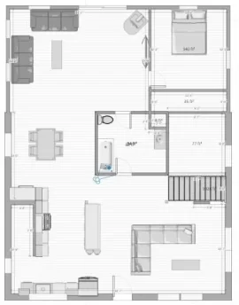

Just as a reference here is the layout of the home after the re-model.

That's a nice open floorplan. It should heat pretty evenly with a convective stove. The location that is shown is ok, though the warmth would be biased toward the livingroom end. The den past the kitchen would end up being the cooler area, but if the place is reasonably well sealed and insulated a little fan help could even out the heat.
What sort of roof is on your home? If it is a pitched roof and the stove's flue pipe is going to come out near the peak that makes it much easier for installation and top down cleaning. If you come out of your roof near the eve then you have to deal with a tall chimney to get proper roof clearance for draft. That can be unsightly and need additional bracing, etc.
Yeah that would be right below the master bed and bath with the kids rooms above the kitchen and den. Between the bedrooms will be a great room 35'wide X 18'deep.
It will be a typical 4/12 metal roof (the remodel consists of new 2nd story with roof trusses). Unfortunately i won't be able to go straight up but will be going thru the wall then straight up with triple wall. Through the eave once i reach the roof. The idea is to have a straight run outside to help keep a good draft and easy cleaning. I would go straight up through the house but the tub and sink will be directly above the stove on the 2nd story and a little nervous of civet fires inside my home. If it means cleaning it a couple more times a heating season I'm ok with that.
