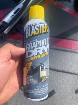

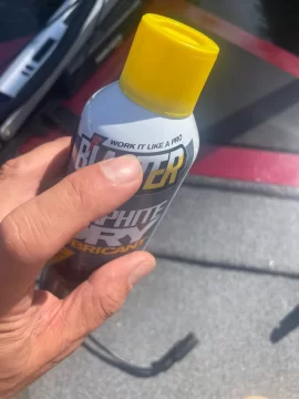

Everybody does it a bit differently, but this is what I do. Graphite doesn’t burn, which makes it live a decent life on a stove door and hinges. Some like powder, I can’t get the powder where I want it. But a quick shot of spray has oil as a carrier to move the graphite where it needs to be. And then the oil evaporates on its own or with the heat of the first fire.
I think I picked this up at Lowe’s a decade ago.
And the best thing is…
It says that since I used their product I can, “Work it like a pro!”
So I got that going for me!

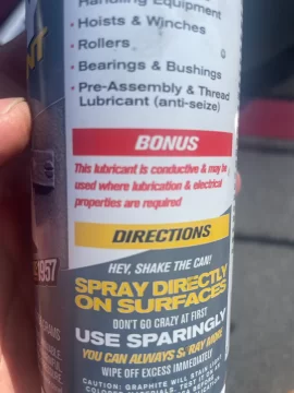

Only if you shake it first, it says.
So no cameras, when you use it, I suggest 😋

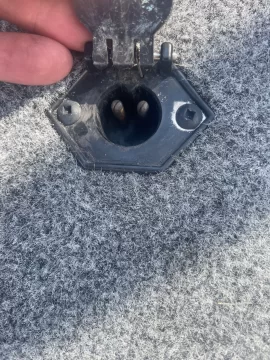

Originally I had it out as I had a bad contact on the plug for a trolling motor. I cleaned the contacts, but it still wasn’t as solid as I wanted. I wanted to see if the carbon in the graphite would make the connection better. I ended up spreading the male ends of the plug a bit and got the contact I wanted. But the next step was squirting a bit into the holes the prongs go in.
