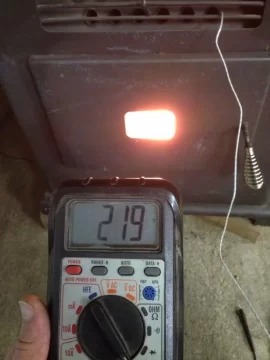

So I'm refurbing this Breckwell Big-E, I think I've now successfully repaired the circuit board (time will tell), and some other little things, but the biggest issue right now is the stove doesn't get the exhaust duct / outlet hot enough, fast enough. The start-up cycle is 15min, but it takes 18-19 min at the startup feed rate for the outside of that duct to hit 110F and trigger the POF. Even 10 minutes later with the stove running on its highest setting, it only read 125F at the POF. I'm burning these white pine "stallion" bedding pellets that were given to me when I got the stove. Could this be the culprit? I can get fir premium pellets here at $339/ton vs the white pine bedding pellets at $245/ton, so there is a considerable difference, but I will do what's best.

Ok, we are fully functional! My circuit board soldering job seems to have been ok as it's now working properly. I took temp measurements and started pulling things apart. Exhaust motor, housing, and fan were fine. While in there, cleaned up the accumulated soot in the output, which wasn't much. Auger got removed and inspected. Sintered bushings got a new soaking in oil. Vacuumed a bunch of crud sitting under the auger base. I removed the auger motor and took apart the gear box, cleaned the old grease out and put in the proper amount of a lighter grease that tends not to harden up and will work with the mixed materials used in all of those gears.
I ran multiple heat cycle tests with the 110F POF snap disc on the bench using my paint warmer which runs up to 145F and found that it had an intermittent fault. I replaced it with one that kicks on 10 degrees higher (for my safety and peace of mind because I'm mucking with the system), but one that also has double the contact area on the sensor, which is what I really wanted.
