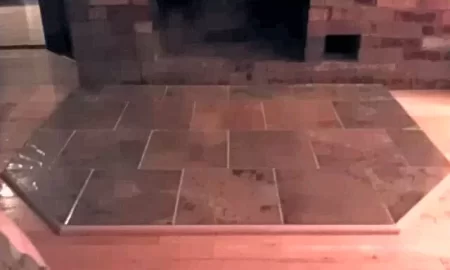

Just finished mine this weekend. Mine is free floating (not anchored to the floor) it consists of 2 layers of Hardibacker laminated with tile thinset, 3/8" bed of thinset and porcelain tiles. I bordered it with a 3/4" quarter round solid oak molding to match existing hardwood floor. Granted I am a building contractor and have been doing this stuff for almost 30 years but, I figured it may give you some thoughts. Measurements for mine are 60" wide x 44" deep to meet specs for my stove. Hope this helps.
[Hearth.com] Stove Pad Oh ya... Pic might help eh?
Reactions: dylskee
Cost for all materials was $140.00. Cheers.
