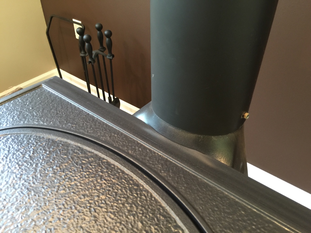

I don't have a connector on the stove. They simply cut the double wall and slipped the inside in the stove flange and the outside over the stove flange. The problem is that every time I take the stove pipe off is that the inside slides out of the pipe and I am never sure if I get it all back together properly.

As to the lack of a stove adaptor, again, best option is to have one. However, I also don't see some real negative about what they did. Except for the hassle you are having getting it all back together. Adaptors aren't inexpensive, maybe this was a cost-saving measure. Or someone didn't know what he or she was doing.

The reason the adaptor was omitted on your install is because of the shape of the flue collar on the stove. Jotuls have an oddly shaped flue collar on the inside that prevents the stove top adaptor from sitting flat, often time the double wall pipe will fit much nicer than the adaptor.

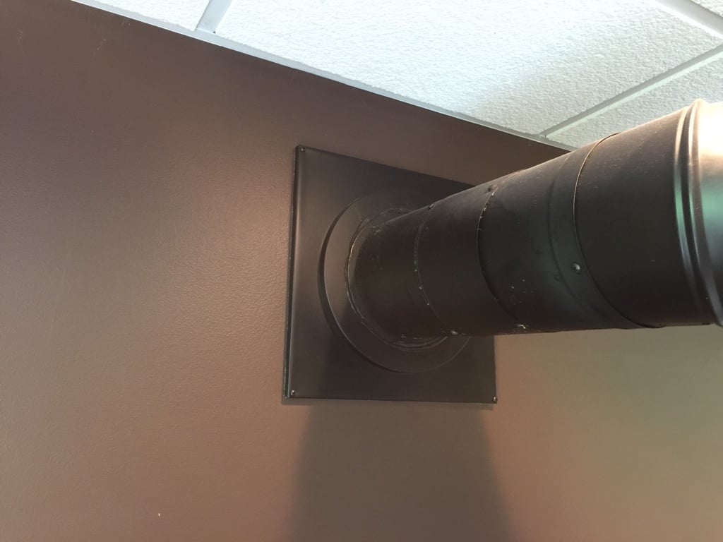

How does the pipe disconnect at the thimble? Last time I unscrewed it one joint before the thimble and I thought the sweep who cleaned it once got it apart right at the thimble.

You have a Duravent system, the stove pipe adaptor at the thimble has crimps on it that often prevent the DVL pipe from being removed. So you might want to just leave that first short section of pipe in place and just work around it. This has been changed in the last few years, first they removed the crimps, now the adaptor is actually a short piece of DVL that's built into the adaptor. It's a much nicer piece to work with.
