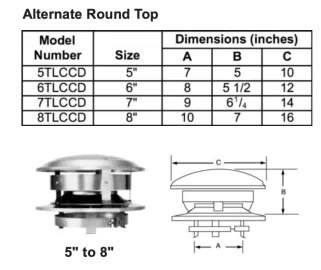

Taking a guess at the chimney pipe brand, maybe Amerivent? A picture of the chimney cap might help.

The cap also looks like Amerivent with the swoopy bottom skirt.
