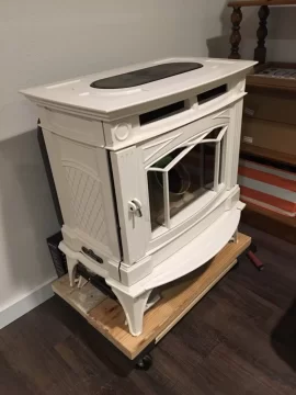

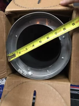

Main concerns are how to make a professional install where the pipe exits the exterior wall (vynal siding) and what to do about where the pipe extends past the roofline. Should the roof be notched out to allow pipe to run straight up, should I add angle pieces to go around the roof line, or extend far enough out from the exterior wall to avoid the roofline alltogether?
Take some pictures inside and out and post them here so that we can see the setup. Also, list the parts you have purchased so that we can see if it's complete.
Is it safe to assume this will be going through a conventionally framed wood stud wall?
[Hearth.com] Stove pipe install help. [Hearth.com] Stove pipe install help. [Hearth.com] Stove pipe install help. [Hearth.com] Stove pipe install help. [Hearth.com] Stove pipe install help. [Hearth.com] Stove pipe install help. [Hearth.com] Stove pipe install help.

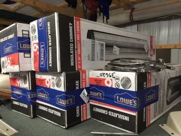

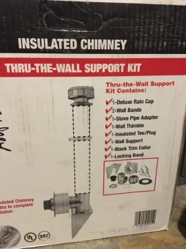

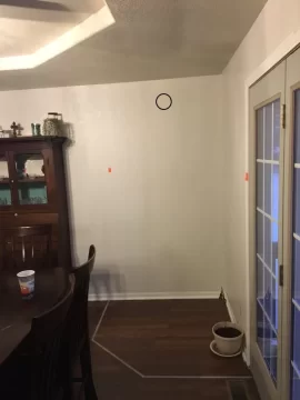

The walls are traditional wood frame on 16" centers. Pictures provide a good idea of my supplies. I would go straight up, but unfortunately there's a second roofline nearly inline with where the pipe would exit the roof. I could probably barely meet the 2" of required clearance around the pipe if I went thru the soffit, however I don't know of any flashing that would work that close to the edge of the roof. I'm thinking my best options are to use extended wall supports to clear the edge of the roof or to use an elbow kit to go around the roof edge. Thoughts on either of those options, or other advise?

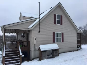

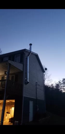

If you have some basic construction skills/knowledge. The through the wall kit is pretty straight forward to install but you probably need 2 people installing it. As in regards to the overhang you can buy offsets which I had to buy 2x 30 degree offsets to run up past the soffit

Thanks, and that looks great! Do the elbows cause any issues when cleaning the chimney?

Yeah I'll try to get a picture when I can, as for the cleaning I haven't cleaned it yet as I have only had it installed less than a month ago. But i think they only make offsets in double wall in 15 and 30 degrees for this reason for ease of cleaning.

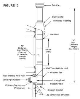

The Supervent instructions explicitly say - Never offset an exterior chimney. If this is the plan you need to choose a different chimney pipe that allows an exterior offset. Before proceeding, think one last time about going straight up, perhaps by placing the stove in a different location.
Do you have the Supervent installation guide? It has detailed instructions covering different options. Here is an outside chimney install going up through the soffit.

I would go straight up through before notching an eave. That just looks like crap to me. JMO. It looks like it will work fine without moving the stove to a different location. You will be well within the area behind a knee wall if the upstairs is already finished.

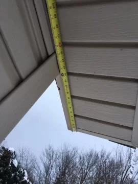

I agree that notching the roof probably won’t look great. Didn't get home early enough to take additional measurements. I’m less concerned about the knee wall being in the way than the second roofline. I’ll take a better pic of what I’m referring to tomorrow when I take some measurements.
