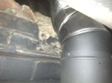

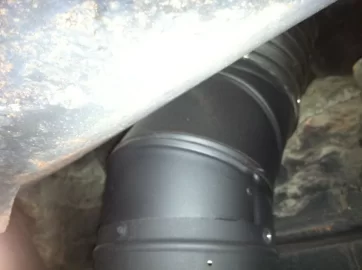

You should be able to feel another section of pipe after putting a piece of wire through the outside hole at an angle..or just look closely with a flash..Where the stove pipe connect to your stove collar , you'll be able to see one section of pipe hanging over you termination collar on your stove... A single wall pipe there will be no over hang or air space,, the pipe will be inserted into the stove collar with no outside pipe hanging over the collar... As far as the probe, it's simply right in the path of the flue gases inside the pipe... I would say there should be no difference from a single wall to a double wall using a probe style thermometer. Picture is of a double wall pipe onto a single wall appliance adapter. You can see the airspace of the outer section of pipe. Little dust on the pipe,eh?;)

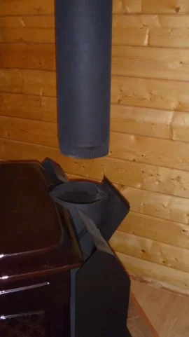

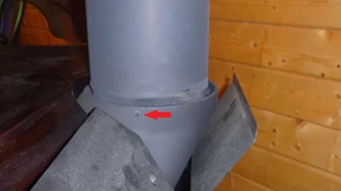

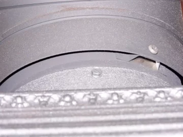

For comparison with Charly's double-wall, here are two photos of my single wall. First one shows it inserted in the collar on the back of the stove (ignore arrow) and the second after I've telescoped it upwards for sweeping.
