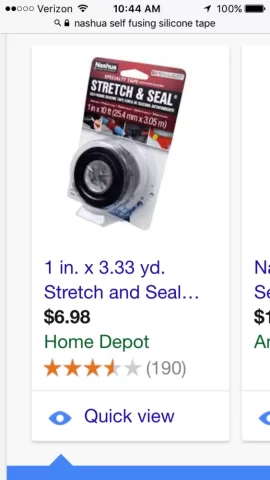

Can anyone post a link to the best self sealing tape to use?
The stuff I found has a max heat rating of 260 degrees.
Thanks All!
This is what I use
  • [Hearth.com] Stove pipe question.
Reactions: Fatherof2
Up to 500deg
Hence the leaks:)
Reactions: Talegas
