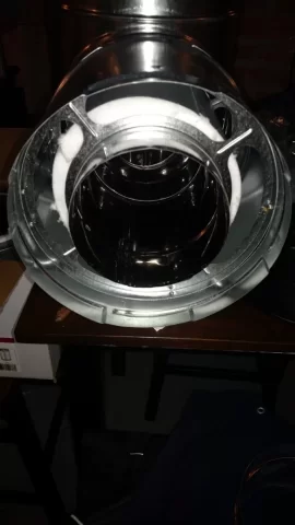

Hey guys I have a question. I had a pellet stove hated it so I bought a woods stove. I will be installing it in the next few weeks. My questions are .I am going out of my basement through concrete block. I won't be using the through wall thimble. Do they make and adaptor pipe to go from the chimney to the pvl pipe. I have some clearance problems and only have about 10 inches when I get inside. So I need double wall at least to the 90 down to the stove. Or do I just use the double all the way down and use the one black part for the wall kit? Thanks for the help
  • [Hearth.com] Stove pipe to chimney pipe?

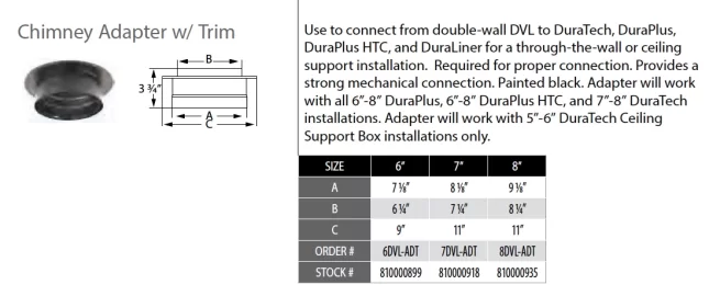

Is this Duraplus chimney pipe? If so, I think you'll need the 6DVL-ADT adapter. Use the DVL stove pipe all the way to the stove.
