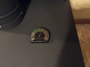

On my meeco magnet the optimum range is 250-550. And on my condar it's 230-475 as best operation. So no 400 is not smoking hot. 550+would be. I run right up past 400 surface temp every reload.

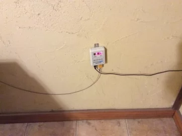

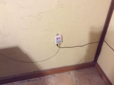

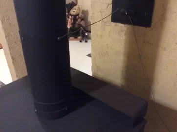

I measure my exterior single wall pipe temp on my summit with a auberin unit with the ring thermocouple. It's much faster acting than the magnet springs and deadly accurate when compared to the magnet and my IR gun. I've seen over 700 on it more than once. I don't aim to go that high but I don't always watch as close as I should.
set your alarm man. Mine is set at 450 I usually shut it back at 400 but It has hit 450 more than a few times

If I set my alarm at 450 it'd go off nearly every time. I cruise at 400 and it drifts back down throughout the burn to anywhere in the range of 200-250 by the end. I heat my stovetop up to 600+ every load too and it will drift down to 300-400 throughout the load. These are numbers for when I want the heat. Not shoulder season burns.

I didn't want to derail the op's thread. Just pointing out that 400 is not smoking hot for exterior single wall pipe temps. It's well within the range of what manufacturers mark on their slow acting magnet thermometers as optimum burn temps.
The condar at over 475 just says wasting fuel. And the meeco which lists its optimum burn right up to 550 just says too hot after that.

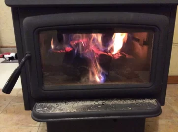

Here's my current load with air cut right back. Settled in for the long hot haul.

I am not worried that it is to hot till it hits 600 either but if I run it much above 400 I fell I am wasting heat. I cruise with my pipe temp at 250 to 275 and stove top at 600 to 700 That seems to give me the most heat while still getting good burn times. Yes I can run it higher but the pipe temp goes up allot without increasing the stove top temps that much. But I totally agree 400 is not to hot. I think it is to hot to cruise at because you are wasting heat but not going to damage anything.
It's been discussed on here a bit before that I think I see some higher temps because I'm reading 12"s up, at about 18"s up i see about 70-80 degrees less with my IR gun, which I verify too against the auberin readout. So where and how you measure all comes into play too. I am commenting on my particular setup.
But I will maintain to the OP that 400 exterior stove pipe temp measured 12-18's above the flue collar is not super hot and if you are all installed and properly setup I'd run it up a good bit higher than that to try to 'cure' your paint before replacing the pipe.
