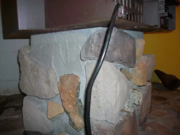

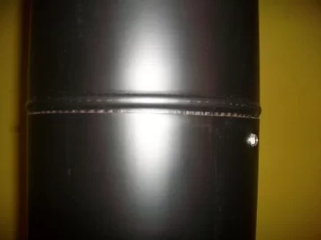

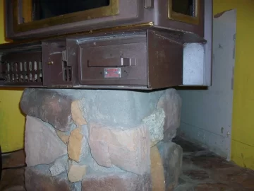

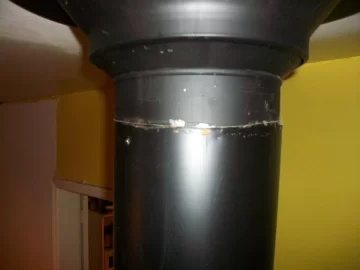

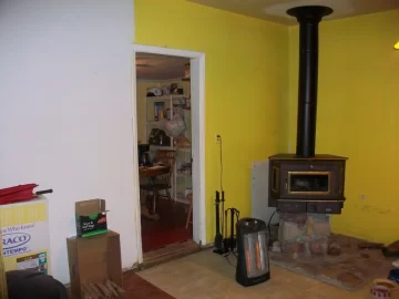

Here is my set up.

OMFG! LOL
You have an insert on a home made pedestal? Sorry, wasn't expecting that.
The first pipe joint don't look that bad. It will split if you push it that last what is it 1/4" 1/8"? Looks like it made it tight at some point, the paint is scratched up to the lip?
How far is the top pc into the ceiling boc outlet? Looks like a screw there, maybe 3/4" or 1" down? Looks fairly tight?
Put a couple more screws in the top seam.
Is that thing more secure and stable than it looks? If that tips or falls off for whatever reason, you are F'd.
Well its actually both, the legs kit is $200 so I thought of building my own pedestal. It is on there and is not going any where. Bending over get to my back so why not put it up so I do not have to bend over. After looking at some of the wood stove here it looks kinda stupid!!!!!! Need to get the legs for it.
Not trying to ridicule you man. To hell with the legs. Just get yourself some cinder blocks, and build a nice rectangular platform that spans a bit more under the stove.
The face it later with cultured stone if you want. Love the height, I will be building a raised hearth for my 2nd stove, when I ever get to installing it. Going to stone face it and put blue stone or like on top.
You could even use some good thick 1-1/2" or 2" 3/8" or 1/4" angle iron and make a nice sturdy base for it.
If its secure and works, that is all that matter. It just looks top heavy to me, and like it could tip off.

Do you know the clearance specs for it? If its that old, it may need to be 36" from all combustibles?
I do know the spec from the top of the stove to the ceiling is 56 and 1/2". I will also be raising mine when i get it as the bending down to put the wood in is getting harder. Tim
Yes the clearance is 12" on the corners. The diagram is on the back of the stove. Its not top heavy as it looks its been there since 2009. I might just add some more blocks to the sides.

Ash pan on the lower right with the handle? BLower on the left. What is the small are between them for if anything? Is that a switch there?
