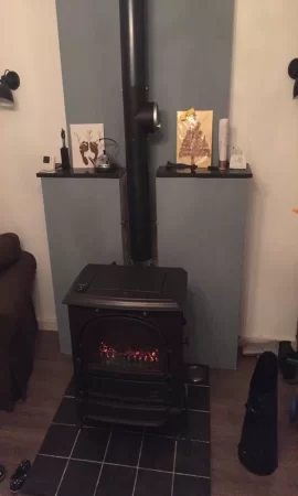

I live in belgium and we burn a wood / coal stove Saey 92. Fine stove but we stopt with burning coal. And going to burn exept wood.

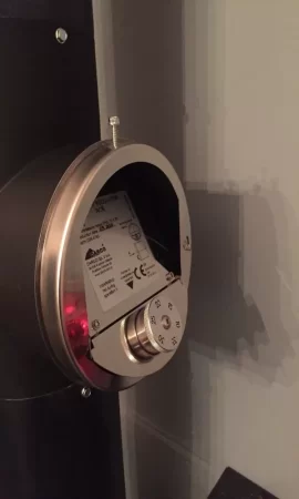

My problem is... we have a stainles steel chimney and my draft when the stove is hot is to much,,, in europe is that 35 pa (pa -pascal) and the stove needs between 10 and 20,,, so for coal i have a automatic damper, works perfect,, also it works perfect on wood but it’s dangerous?
When i burning the wood without the damper its always verry hunted fire, al the hot go’s to the chimney, i need always put al valves close of the stove so the fire is nice and easy burning without smoke and the stove is much more hotter than.
Also my window is fast black when i have hunted fire because i think the stove is not hot enouph.
What is my best option to do? Remove the automatic damper and put a mpd in the pipe?
Thanx a lot greets Paul

The danger with the barometric and wood burning is that the air diluting the draft cools the flue gases. Until the wood has burned down to coals it is emitting volatiles. When these gases get below 120ºC they can start condensing on the cooler parts of the chimney. This condensation is creosote which can plug the chimney and it is flammable. A manual damper does not introduce air to slow down the draft. This is better for wood burning.
Yes, that is strong draft. I'd remove or at least cap off the barometric damper if coal is no longer going to be used and install a manual damper.

Can you thel me where the best place for mounting te mpd? Is it possible to put it where i have the autodamper ? See pic.
