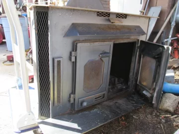

I am going to clean up my Buck 26000, and try and make her look new again, and was hoping for some tips and tricks from those of you who have done this in the past.
She isn't in bad shape, just needs some touching up here, a bit of cleaning off surface rust there.....etc.
The manual says to use paint for touching up in the offseason. What paints have you all found work best?
What about stove polish? Pros/cons between the two?
Should I worry with the firebox?
Got her for free from a woman who was cleaning out a storage building she won the contents of during an auction. She said she didn't have a use for it and couldn't move it even if she did. LOL! Here she is in my garage, waiting for a facelift:

Here she is on her ride home with me.
[Hearth.com] stove restoration tips?
She is missing the glass from one of the doors, and no trim kit, but everything else is there.

Amazon sells pretty inexpensive sand blaster heads, (use your own compressor) Harbor freight has some cheap heads also....I would try it out. After that any good high heat paint would do the trick, colors even available....I just purchased some Rustoleum Green for a project....post photos, nice stove....
Kevin, the stack came with it so I dont know its origin. It looks to have never been used, so may be a custom job. Send me your email and I will send over some good pictures of it.Funny you mention replacing yours. I want a tripple wall 27000 to replace my double wall 28000. I dont think the stove NEEDS sand blasting, but would that give me a better finish?
Stove polish is for rough cast iron, not steel plate. It will not stick to smooth machined surfaces either. The waxes and pigments in stove polish are near impossible to remove once heated, so if you have a stove already coated with it, you have a real job getting it off if you want to paint.
Stove Bright paints by Forrest (Satin Black) is what you want and will remain the darkest without graying. For a more high end finish, you can use Black Metallic, but that was not original. Most all stove and BBQ paints are good, be aware of the special steps necessary when painting over DeRusto ; Mentioned in the first post of the Everything Fisher thread here; https://www.hearth.com/talk/threads/everything-fisher.48309/
It is also the most dangerous to breath, so wear a mask, preferably paint outside and burn off outdoors for final cure if possible with a couple pieces of stove pipe. There are many posts and threads in the Fisher Forum about restoring with pictures.
You don't have any deep pits that require sand or media blasting. Wire wheel any loose bad spots that I don't really see on yours, then lightly sand before painting. A regular straight wire wheel in drill is fine for light surface rust, a cup brush is more aggressive and a knotted cup brush is the most aggressive. (you don't have heavy rust requiring that) Wipe with mineral spirits, and lastly lacquer thinner before paint.

Rust-Oleum, Krylon, Rutland....... all make 1200 degree paints that work fine, but will be flatter, more dull, and not as black as the Stove Bright.

Thanks for the input folks. I have rustoleums high heat flat black. I may use it for the back, sides, and top, and find some stove bright for the front...since that is what you will see as it will be an insert.
I had used a base coat of the rustoleum high heat and a top coat of the StoveBright metallic black on our pellet insert and on our coal stove. The metallic black seemed to hide some of the imperfections in the metal better than the satin or flat black.

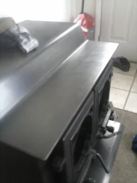

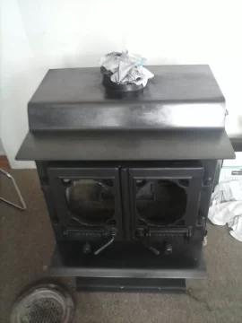

So, I know this goes against the grain of aforementioned advice, but you can use stove polish on a sheet metal stove, and to superior results compared to paint in my opinion. You can achieve a high gloss gun metal type finish with the correct technique. I think it looks a damn sight better than common flat black or even the black metallic. It helps fill minor pitting too. Most people that knock using polish on sheet metal would be suprised.
Pictures, or it didn't happen!
It most certainly did:
[Hearth.com] stove restoration tips? [Hearth.com] stove restoration tips? [Hearth.com] stove restoration tips?
I have pics of another stove about 5 years in service with polish if there are any ?'s about longevity.
Thank you Richard! Do you buff your polish after it has dried awhile and is it a paste or liquid? And do you have problems with it being messy even after you fire cure it?
I'm guessing I don't buff it enough, leaving residue. I have the paste never seen the liquid.
Richard
After you fire it a couple good times, hit it again and she will buff out a little more. And if you get any thick areas of paste (swirls,lines and such) that a cloth won't rub out, use the finest grade of steel wool and apply NO pressure or it will pull right of (if never fire cured). Once the stove is cured by heat, it won't rub off like when its green. The very fine steel wool helps keep a shine on it afterwards for general cleaning and polishing. I've never used the liquid either , just read bout here.
That looks very nice. How many times did you have to fire the stove to cure it, and did you buff each time?
It will cure with just one good blaze, but you may smell the wax still cooking off the first few fires. The stove Pic I posted has yet to be fire cured. Usually buff once again after being fired, then as needed for maintenance/looks.
