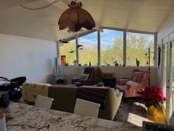

Hello. Hope everyone is staying warm. Rebuild complete check it out. JK . I bought a new one. Now for the install. Question - how long laterally out the back can the stove pipe go? What my wife wants is to go through that wall and up on the outside. On the other side of that 2x4 wall is an exterior patio with a flat roof and I have to clear a rafter. So about 18 inches horizontally i need to come out the back of the stove and then the chimney would T up ? Will it draw good like that? I couldn’t find anything in the manual and i called woodstock and left a voice mail. My plan is to cut out that section of the exterior wall between the blue tape and make it all brick so the stove can be real close to it. Does that sound like it would work fine?

18" horizontal depends on how tall the flue will be vertically. The vertical part generates draft, the horizontal part kills part of it.
Also making that wall brick: if still on studs then you only gain 1/2 in clearance as you take the drywall off.
Clearances are to the nearest combustible regardless of what (eg. Brick) is in between stove and that combustible.
Reactions: Todd
Thanks. That is very helpful. Im going to cut all the combustible and put a header in to screw the mantle to 30 inches above the stove.
I have 20 ft of chimney to go up with if i need it. I think it needs about 12 to 15 to clear the 10 ft high point. Any idea how tall you think it needs ?
Reactions: Todd
I don't know your stove well enough to be sure but 20 ft will likely be okay imo.
Look up the 10-3-2 rule for chimney height requirements in view of clearing roof ridges.
I’d opt to go straight up but with 20’ chimney I think an 18” horizontal will draft fine. Wish I was closer I’d take that rebuild off your hands.
Congratulations. Straight up would be better but It will probably work ok if the chimney height outside is 20'. The effective height with the 18" horiz. section and the a 90º turn at the tee will be around 16'. Tucson is at about 2,400 ft. elevation so it's on the cusp with the altitude adjustment. However, IIRC this stove is an easy breather. I think we had an old timer running a Fireview on a 13' flue years ago.
Use an 18" section of class A chimney for the tee snout going through the wall with the appropriate class A thimble.
I have the Fireview baby brother (Keystone). My install is about an 18" horizontal to a 27' vertical. I'm at 1100 feet. That drafts very well, and I am borderline not needing the in-line key damper I installed (I may remove that this spring). I think you might be just about perfect with a 20' vertical and 18" horizontal (even at altitude). A little extra height probably won't hurt you. I end up running the stove at 0 secondary air during colder days.

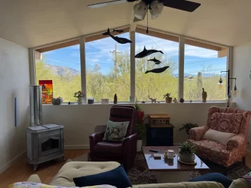

Right on , Bob! Wohoo I got it figured out. It looks real nice here i think and you can see it really good from the kitchen. The corner placement is the ticket. Our house is small - only 1200 sq ft , which was what was making the placement a little tough - the living room is only 16 feet wide across the big windows.
the wife likes the idea of using the smaller DVL pipe inside. Then I will go through the wall with my kit and have the T outside and go through the patio roof. That block less of the window plus no chance of leaking in the living room .
One last question — do you think i need a damper in the stove pipe? I see they sell a DVL piece with a damper.

I don’t think you’ll need a pipe damper. The Fireview is very controllable unless you have a very tall chimney. I installed one and used it often until I took care of a couple leaks I had from the rebuild but now that the leaks are fixed I rarely burn less than #.5 and that’s on a 22’ straight up chimney even in below zero temps and high winds.
Reactions: biopete
I second what Todd said. The catalytic combustor does a lot to slow the draft down. With a one story house, you can't possibly be approaching the chimney height that would require a pipe damper.
