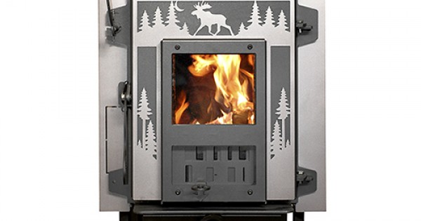

That's a pretty small space. Take a look at the Woodstock Survival stove.

That's a tough one. Your small area and high insulation work against you. The warm temps compound things. The high window area will probably help! I think you're going to have open windows regardless!
I'd go small. I think I'd look at sub 1 cubic foot small. I'd look at any way to increase the thermal mass of the structure and stove. Stone, cast iron, etc. Once the cabin is warm, it won't take much heat to keep it there. A small 15k btu sunflower heater on a 20lb propane tank or a Little Buddy will get you up to a reasonable temp fairly quickly. Then you have to hold the temp without cooking yourself out of the place.
