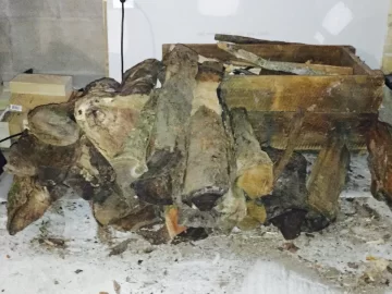

I'm loading E/W b/c my wood is mostly cut to 18 inches long. The wood is pretty dry it's been cut and split for around 3 years moisture meter says 18-20%. The sizes vary but I try to keep it to I splits I can pick up with on hand.

Its the pic. The wood was stacked on the ground befor I got it so it's really dirty. It's been stacked on a pallet for two years since I got it. Mixed hard wood. Mostly cherry. Some walnut maple and oak here and there
Than its a really bad pic. Because it looks half wet and half rotten.

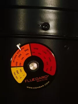

We have a prob thermometer in the stove pipe(double wall). Then I have been using a in thermometer on the stove top for now till I get another Can you recommend a good one for on the stove top?

I'm partial to Condar thermometers.

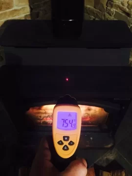

feeling a little less discouraged tonight. I took your guys advice and started re splitting some of my wood in to smaller splits, periodically checking the moistur %. I came across a section of the pile that had a bunch of nice dry sugar, silver maple,some black locust,some black walnut and a bunch more cherry. Partially filled up the stove tonight a couple hours ago brought it up to temp and have some nice secondary's going.

Behold the beauty of dry wood. Happy wife?
She was asleep so she didnt eve get to see it lol. But she was happy to hear I found some of the wood to be dry when I told her this am.
