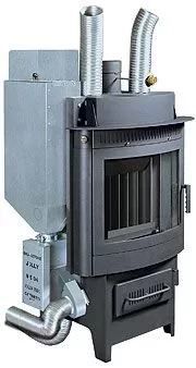

That's a different animal, I think it has forced draft. The question was is there a woodstove that burns both fuels. No wood stove that I know has forced draft except a pellet burner. They work well because they don't try to burn a mass of pellets at once.
I love the look of this beast. It looks like the robot on Lost in Space.
