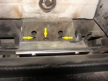

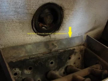

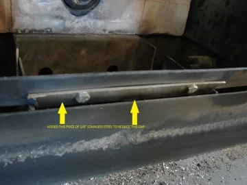

Window screen was too restrictive when I tried it so I ended up using 1/4" screen just to keep critters out and it worked much better. Here are a few air mods I did. I added a piece of 1/8"stainless to the air wash gap to restrict the air and send more through the burn pot. An added benefit was that now the velocity of the air over the glass increased and keeps the glass cleaner. Another mod was to drill 3 extra holes behind the burn pot. I also bent the top/back of the burn pot lip so it was tighter against the fiber board. I also run my stove in corn mode and replaced the 2RPM stirrer motor with a 1RPM motor to keep the fly ash down.

Awesome info there,...thanks for the pics too...I wondered about the air holes...how did you drill them?

To drill the extra air holes, I had to cut down a 1/4" drill bit and use it in a pneumatic angle die grinder. That's the only tool I had that would fit in that narrow space.
