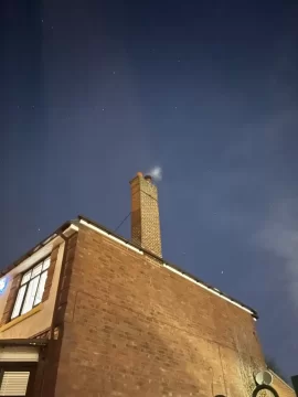

I did check our chimney outside but didn’t notice anything strange, just normal white smoke. (Unless that’s considered strange)
Not the best image in the world as it was quite late at night.
