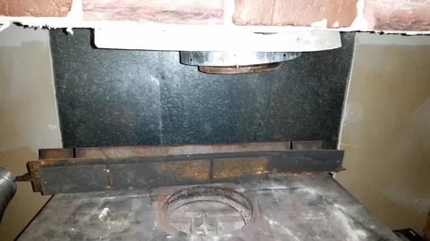

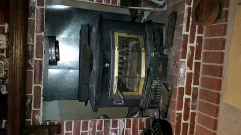

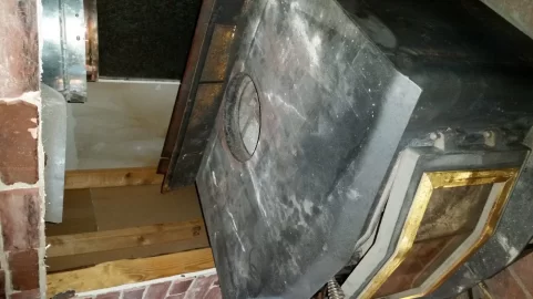

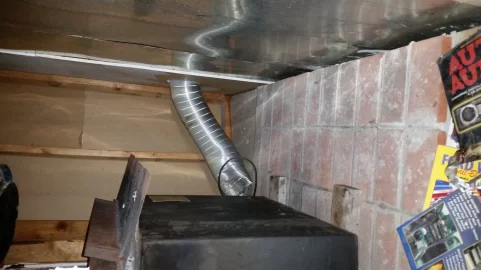

New here to this forum although i gathered a lot of valuable information here. So here it goes. Decided to ditch my old preway manufactured fireplace- 8 inch flue and install an appy 32bw insert instead. But as always there is a safety issue. The fireplace is a faux brick on top of sheetrock on top on wood studs and the hearth is a brick paver on a wood platform . 8 inch double lined galvanized pipe. So, should i tear it all out and start anew, go with a zc insert like a nappyz26 or reinforce what i have

This is a total no-go. :ZZZIt is not a safe installation. The insert should not be installed in this area. Don't proceed. It is not a valid alcove even for a freestanding stove.
Replacing the whole shebang with a modern EPA insert is a much, much better plan. This may require replacing the chimney pipe as well.
