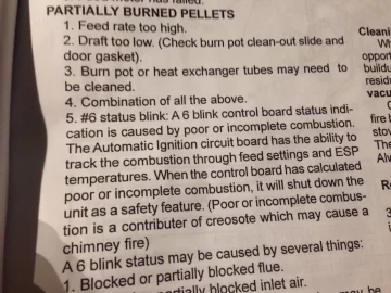

Thanks for all of the suggestions! When I got home today, stove was off and error code was flashing 6. According to my manual, that's not good. I am going to inspect the chimney outside tomorrow and make sure there isn't something obstructing it. :-/ [Hearth.com] Sudden Soot Build Up on Door

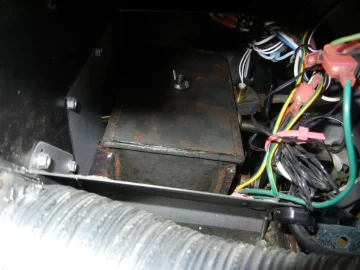

Im not sure how to access the fines box. Can you advise?
Remove right rear panel when looking from the front. Wing not on bottom of box. Lift and remove and vacuum out. This box holds all the fines or dust when you dump pellets in. It will fill up and needs to be cleaned periodically. Download the owners manual.
Yes! That had a lot of build up in it! I also snow shoed out to the vent outside where I find lots if chunky blackened bits clogging up the vent gaurd / mesh. I think i fixed it. Thank you all for your help. Ive been cleaning regularly but this is our first season and Ive obviously got a lot to learn. Your help is MUCH appreciated!

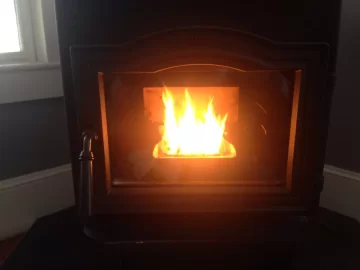

  • [Hearth.com] Sudden Soot Build Up on Door
