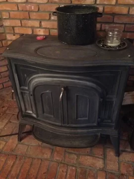

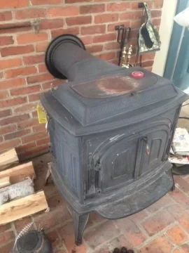

Hi all, not a woodstove expert but been browsing these forums for a while and decided to ask for advice on my current situation.
I recently bought a 2400 sq/ft 200 year old brick farmhouse. It came with 2 woodstoves which I have been using as my primary heat source. Both are Vermont castings, one defiant, and one vigilant. The vigilant works great and is used to heat a living room, bathroom and small bedroom. Its easy to use, not very smokey and can easily run for hours in the 300 range (stove top temp).

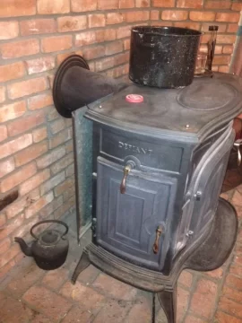

The defiant is a different story. I know the stove needs some work, gaskets, seals around doors, etc. No updraft problems but when i run in horizontal (handle down?) mode it gets very smokey. The stove other than that runs ok. in vertical mode (handle horizontal) stove runs great and can get up the 500+ range. It runs a little cooler surface temp but generaly around the 300 degree range. The burn time is not as long though.
For both stoves I have an 8 inch pipe that goes directly into the chimney behind the stove. (brick with new liner in 2013)
I plan on living in this house for a long time and I want to make the right investment. I know that there are tons of insulation and gaps that need to be filled to make the house feel warmer (home energy audit being done soon hopefully) but I am curious if replacing the defiant is the right move. The first thing that comes to mind is the ideal steel. For the price I could replace both stoves over the course of a few years. With the layout of the house (L shaped) i think 2 stoves is the way to go.
So I guess my question is: Am I thinking correctly that a more efficient stove like an ideal steel is the way to go? Will that give me longer burn times and more heat than the older defiant? Will the ideal steel have any problems with my chimney setup?(8" pipe that goes 14" directly into brick chimney 29" from floor approximately 20' high) Will the ideal steel or similar more modern stove use less wood for more heat? Money is definately a priority for us, since there are lots of other projects that need to be done. But I do want my family to be as warm as possible for as little wood as possible and as safe as possible.
Thanks again, sorry if I left out any important information.

I owned a vigilant for a few years and liked the stove pretty well. I had the same problem with it that, you seem to be experiencing with the internal damper being in the closed position. When it is closed, it forces the smoke and hot gasses to circulate around the back and sides before exiting out the flue.
I found in mine that the flue gas passages, had become blocked with ash and a few (already demised) starlings who had found their way in over the winter! Once cleaned out, it circulated fine!
A new, more efficient stove could give you more heat for less wood, but you are looking at a significant investment in purchasing the stoves and lining the chimneys.
If it was me, I'd plan to replace the stove that isn't working well sooner and the one that is working well later, and spend the money in between on insulating the house.
We definitely have some subject matter experts here who will no doubt be along shortly with some better advice, though.
To me 300 on the griddle is a cold stove you need to keep the flue gases over 250 all the way to the top. Higher flue temps equals less smoke, if your stove top is only 300 then it would be hard to maintain those temps on an external masonry chimney. If you can play with the thermostatic damper on the back and keep bumping it up until you dont see smoke out of the chimney. I have a feeling when you get it to that point that stove will come alive and crank some heat. The defiant was the first and largest stove they made and if I am not mistaken was meant to heat 2000 + sq ft on its own.
More heat equals more fuel they are not as efficient as today's stoves but they will crank a lot of heat. if you are using a magnetic stove pipe thermo to gauge the temp of the stove keep in mind they are not all that accurate, I tested mine with an infrared thermo and found out that the hotter the stove got the less accurate the stove pipe gauge became.
