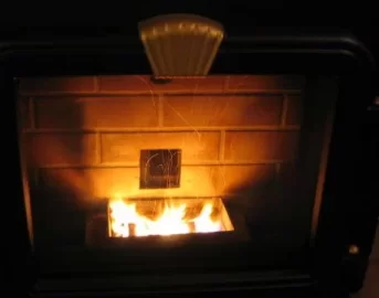

Big & orange flame is what you DON'T want. Flame should be shorter, very active, with yellowish flame with a hint of blue at the base.

As for the flames, on a setting of 4-6, my flames are maybe 1" above the edge of the burn pot, and very active.

Don't know if this helps, but here's a pic of what my stove looks like during a regular (meaning AFTER initial start-up) burn. Stove was on 4-6:
