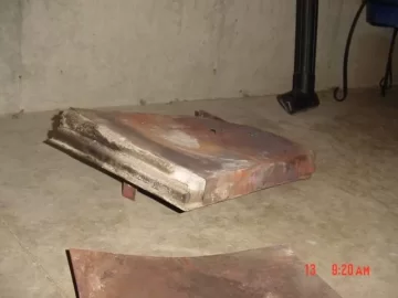

my baffle has a decent bend in it. went to the local stove shop yesterday and they told me it was junk and i needed a new one. i read a post by hogwildz and he said he bent his back the best he could by hand. sounds good to me thats what i was thinking. anyway its $225 and don't wanna spend that much when it could be fixed. als0 the "secondary air deflector plate?" came of it seems the nut came off somehow this is bent also. heres some pics let me know what you think

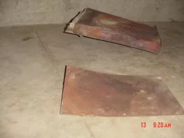

oops heres more pics

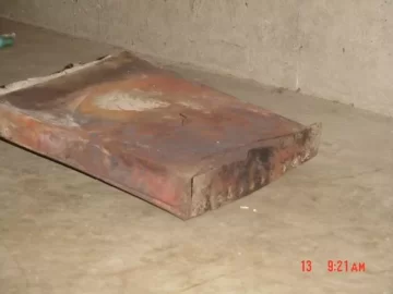

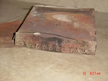

one more sorry : ) it wouldn't allow me to put more tha two pics in a post????

It's kind of hard to see in the picture. Is that a hole in the plate or a blanket clip? If a hole, that doesn't look good.
How old is the stove and plate? Just wondering if this is a warranty item?
that is a clip on the plate and the stove is two yrs old. they told me it wasn't warranty???

The stove is only 2 years old? What did you burn in there? Lumber scraps? Looks like its been overfired? Maybe that is why dealer stated it wasn't covered?
My baffle in my wood furnace was warped worse than that, but it was 20 years old. I took it into a local fabrication shop where they put it in a press and welded reinforcements on it so it wouldn't warp again. I had that done, and had a baffle support made with a 3/16 plate and it cost me 60.00 I had the welder, So I tore it apart and rebuilt it. If there is a weak spot, or hole replace it. If its thin I wouldn't think about repairing it due to the fact of the high temps. If it needs replaced and the stove mfg won't warrant it. Have a new one made. That is some pretty serious warping if its only 2 years old. I would go over the rest of the stove to make sure things are okay. Better safe than sorry.
the stove was overfired. my better half used to leave the damper wide open quite often before should would go to bed and forget about it until a few ours later when i came home. the rest of the stove is fine no warping of anything else,, stove itself is not all white on the outside like others i've seen. took fire brick out and everything looked ok. can i save this?? i like the idea of bringing it to a machine shop
I would say, no, that baffle is not savable. Warped WAY beyond repair. Sorry to say you're going to have to plunk the money down for a replacement part from the manufacturer. Replacing that baffle with something made locally would void the safety and emissions listings of the stove.
