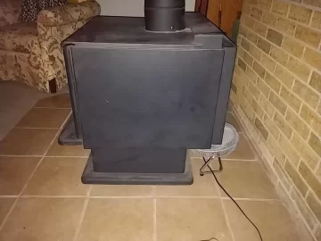

This actually works very well. It was an emergency solution to move more heat, and it hasn't been put away. I can't justify the expense of a proper blower, it works so well.
It would be pretty quiet, but the fan is on its last leg and sorta rattles. A lot.

Thats my next purchase when my blower goes out again! Motor with twin squirrel cages was $100 to replace. I can probably buy 4 or 5 of those fans for that price! And dissapointed in how loud the blower is. It's LOUDER than the original! Those little fans are much quieter.

That's a good idea. I'll have to go pick something up. How does the blower attach anyway? Does it simply blow up on the rear shield forcing air up and over the top of the stove out the front?
