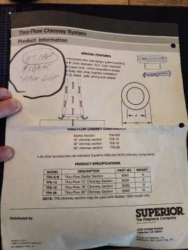

In doing my own quick research after locating the original paperwork for the appliance from the prior owner, I wasn't sure if this adapter would be compatible which would enable me to just do the pipe replacement and chimney height increase. TF8 to 8DM Adapter
I am certain that the appliance uses TF8-S/S piping in the starter section per the product information.
