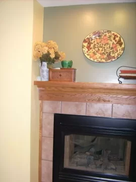

Currently we have a double sided propane fireplace that doesn't generate any type of heat to supplement our furnace. Is there anyway that we can upgrade or add to our Heat-n-Glow fireplace to lower our heating bills? Currently, there is a B-vent chimney going through the center of the house. Any helpful suggestions would be appreciated. Propane costs are outrageous.

It is definitely B-Vent and not a Direct Vent? Even if its B-Vent the unit should still be fairly efficient and put out some heat. How old is it? Can you get under it and find the silver sticker and get the model number off it for me?
Model #ST-TRC made by Heatnglow
80% efficiency and does throw off some heat. It's rated at >21,000btu/hr. My problem is between this and my furnace, The propane bills are $600-$700 a month. I would like to find a cheap alternative supplemental heat source. Our house isn't set to add a pellet/wood stove in another location. So i'm trying to modify this one..

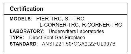

I hate to argue about this but if you truly have a ST-TRC you dealer is mistaken. The unit is a direct vent, and cannot be installed with B-Vent.
I attached a clip from a manual I found online
(broken link removed)
B Vent units almost always have something like "TV" or "TVFL" or simply a "B" in the model number. I will try and dig up the B Vent model from that era.
Now... I know we have a hotel with a B-Vented DSI See Thru unit and I'm trying to remeber the model.... It is similar to a ST-TRC but it would have to have a tag on on the model # to make it B-Vent, I want to say it should be a ST-TVFL but I can't find a manual for it from home.
