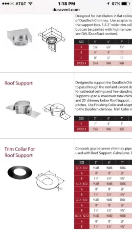

Did you use a roof support? I'm no installation expert, just reading the catalog.

I did not. I have never seen this component in any of the literature I have.
Thanks for this. I'll be installing another stove soon, so I needed to know this.
