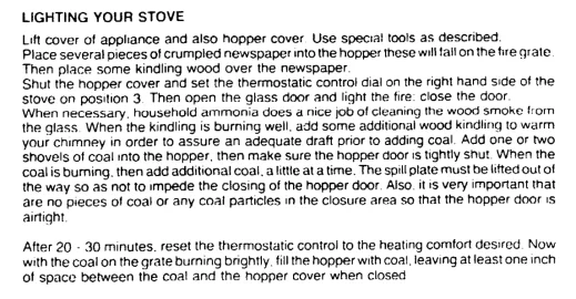

Not a coal stove owner, but this is what is in the old Surdiac manual in the Hearth.com wiki section. Hope that helps.
