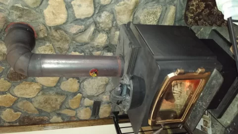

Hi! First time posting on here! I was wondering if it were possible to use my existing Wood stove vent pipe if I were to switch it out for a pellet stove? If it is what would I need to do it? Any help is appreciated :) [Hearth.com] Swapping out wood stove for pellet stove...?
Depends on the stove... you would have to read the manual. Some Quads and Harmans permit such an installation into a proper existing vent when using their top-vent-adapter kit.

I bought a used Integra II pellet stove it had a adapter to go from 3' pellet pipe to 6" stove pipe. I saw the stove work before I bought it it worked just fine.
When I bought my old quadrafire castile the stove shop said the large 8" pipe that was part of my old manufactured fireplace could overdraft the stove making it not put out enough heat but couldn't say for sure.
I made a similar switch by using pellet vent pipe up to the masonry adapter and then a short piece of flex to get the exhaust pointed up the chimney flue. Burns fine but haven't run enough pellets through yet to check and clean the chimney.

Been useing 6 in. class a chimney for 12 years with out a problem 7ft of pellet pipe to it.
It was used for a 0 clearance fire place before. Easy to clean and even made

that what i did when i switched from wood to pellets.

My pellet stove sits in the center of my basement . The 3" vent runs into a 6" triple wall stainless pipe thru the roof. I bought the reducer at home dep. works good

Yeah. My pellet stove in the basement uses 3" pellet vent to a 6" 90 into a thimble into a 5.5" liner and 31' straight up to the sky. Works a treat.
