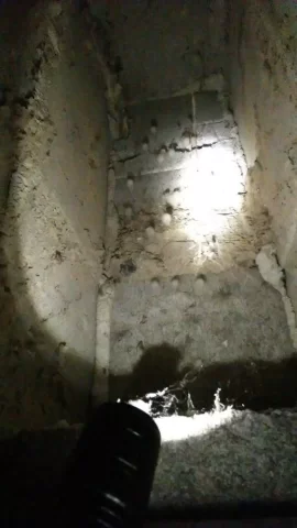

I also have an ash trap in the bottom of the fireplace that the installer said he would clean out from the outside clean out door. We took pictures inside the the ash pit from the outside door. It looks like the opening was either sealed or has just been sealed shut from built up ash. Either way it doesn't look like they cleaned it out given the spider egg sacks and lizard poop we found on the floor of the floor of it. If there is a bunch of ash in the ash trap could that be the smell I'm getting?
