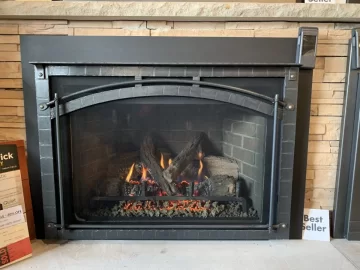

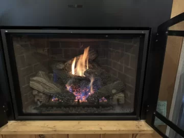

Went to see both units yesterday. It was good to see both on the same day within a short time of each other to be able to better compare and contrast the units. I have attached pictures of both units running on high for comparison for others to use in the future. The Mendota has a much more realistic looking flame. It also has two burners so you can shut down the rear flame if you want. The HeatnGlo is a noisier unit by a fair amount when running on high . The HeatnGlo has a 120 CFM single fan assembly. The Mendota has 190 CFM using two separate fans. The airflow when running on high is much higher out of the Mendota. I'm 99% sure we are going Mendota at this point.

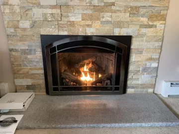

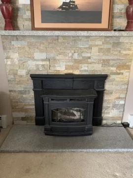

Just wanted to update this post with a final outcome. We did end up yanking the pellet stove and installing the Mendota insert running on propane. Very happy so far, although I am still working on the break in of the insert. Lots of heat, not nearly the maintenance of the pellet stove. Much quieter fan operation. I will try to update again in the middle of the winter after we have put this unit to work but I don't foresee any issues. Attached are an old picture of the pellet stove and the new Mendota insert. We are probably going to get the next size up surround to showcase the decorative front a bit more.
