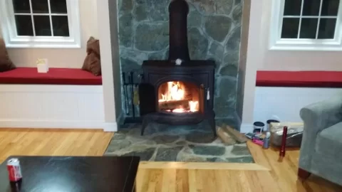

My hearth/half alcove is 59 1/4" wide and 46" deep. The floor and back wall of the hearth are natural stone, while the side walls jut out 18" inches and are drywall. The picture should help.

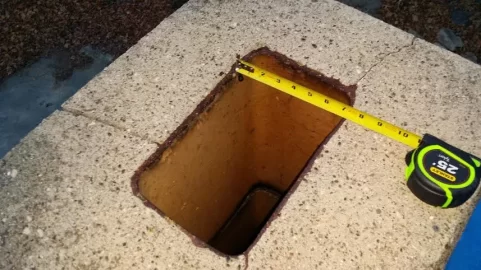

Chimney around 24 feet as I bought a set of brush rods to 18 feet and a 6' extension and used all of it. This picture is not of the chimney itself (another I have) but it is very similar. The liner sticks up maybe around 3 or 4 inches, I was able to get on a SS cap on it last year. 11" by 7" liner. This is a clay liner, correct?
It's a terra cotta lined chimney, yes. Most of the following comments will be to get a SS liner installed. On another note, I replaced my Defiant with a Jotul Oslo and absolutely wish I had just kept the Defiant. Perhaps my opinion will change over the next couple burning seasons, as I'll have wood more suitable for the Jotul.

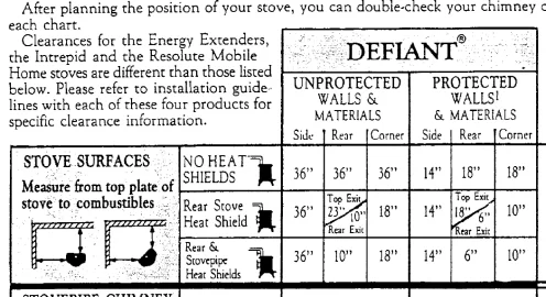

The current clearances for the Defiant look woefully short. Is that just a stone veneer on cement board behind the stove or a full masonry wall to the exterior? The closest the Defiant can be to an approved NFPA wall is 12". The side clearances are definitely too close. There is supposed to be 36" to the unprotected side and rear walls. The clearances can be reduced only if A) the wall is entirely non-combustible (masonry all the way through) or B) an NFPA wall shield is in front of it. This looks like a risky install and one that insurance would not approve. If the decision is to keep the Defiant proper wall shielding needs to be installed. Do you have the manual for this stove?

The back of the alcove and floor is solid natural stone with mortar. I used Durock as I thought the side clearances looked poor and wanted it safer, and I'm sure it at least helped a little. I have the manual, I was just unable to do anything (or so I thought) until the end of the season. This is another reason I was thinking of switching the stove.
