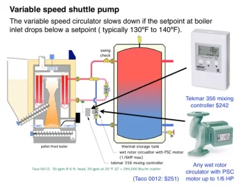

I believe a tekmar 365 works, if you put a fixed resistor on the supply sensor to "fool" it to thinking about 220F or so.
I'm not sure that you could run an Alpha or any ECM with a variable speed, PWM signal control however, I'll check with Grundfos.
Grundfos has plenty of circs that have PWM built in, but only in European versions 230V, 50hz. I have a few samples and they come with two PWM connector wires out of the motor. With enough interest I suspect the solar ECM pumps would be the first to be US ready.
Here is a possible option for a high flow pump, about 35 gpm, for large 350,000 BTU/ hr. boilers. For smaller flow rates the price of the pump drops considerably, of course. I believe this, piped properly, would thermosiphon during power outages. Thanks to Siggy for the drawing.
  • [Hearth.com] Taco HEC-2 Bumble Bee Reverse-Acting Control
