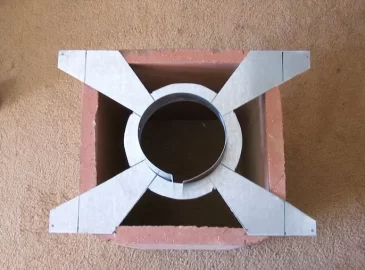

I faced a similar situation last winter, wanting to put a woodstove in my basement workspace. The natural gas boiler down there vents into a huge 13x13 terra cotta lined chimney - way oversized for the boiler's 6" exhaust . The stove and the boiler would never be operating at the same time (the boiler hardly ever comes on any more except on the coldest nights.) So I decided to run a 5" stainless rigid liner up the middle, which leaves plenty of area for the boiler exhaust. I had to fab a piece to secure the liner at the top of the chimney, see the pic. Other than that, it was just like any other liner install - a thimble through the brick and terra cotta, and a service entrance door on the other side for easy cleaning. I finished it right around the new year and it works great.
