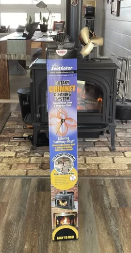

well, i bought it... now hoping i can/will learn how to use it.

suppose i could donate my new-never-used-6"brush and the fiberglass rods...
I sure hope that works out real well for you and so glad you now have a option not to go on the roof and clean from the bottom. I had my stove installer come and clean my stove last week and he did it from the inside but he wore a mask with two breathing things sticking out on either side and this was for safety and maybe something like that would be good to buy while you get used to using your new tool...clancey
Used the same set up yo clean my Buck 81 last week. Pulled the first 3 burn tubes out, removed both baffles and the insulation blanket which took longer than the cleaning process itself. Had my shop vac hose end sitting in the firebox with the vac running as I ran up the liner with the brush spinning. Worked great! Not much less. Much nicer than getting up on the roof which hasnt been possible here with all the snow. I highly recommend this or similar product.
You’ll definitely want a good strong shop vac to use while going from bottom up. That or using a sheet of plastic around door opening to minimize soot coming into room. Lots of people here seem to have perfected this pretty well. I was messy with going from bottom up, so have done top down with sooteater (easy roof to get on). Let us know how things go with cleaning. Cool looking stove set up BTW.

well, i wasn't planning on going thru the stove to reach to flue... my idea was to remove this first section of flue to clean...
or is my thinking wrong?

Nothing wrong with taking a piece of pipe out. Do tape a bag to the pipe thru which you go up after poking a hole in it for the first rod with the wires. Tape it to the pipe and add sections of rod. And maybe have the wife hold a vac near where the Ross out of the pipe.

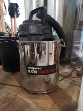

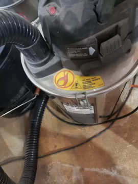

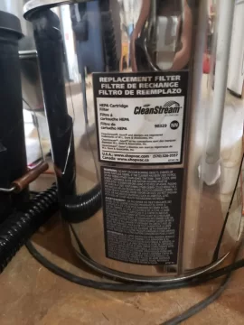

I bought myself an ash vacuum back when I started burning (8 or 9 years ago now). The HEPA filter is the main attraction of the so-called "ash vacuum," as this is the component that will save the motor from a premature death (very fine particulate such as ash and/or drywall dust are murder on vacuum motors). Other than that, there isn't too much difference from a normal shop vacuum, as neither type of vacuum can be used to clean out live, hot embers.... It is very handy to have when cleaning up the stove though; I usually hang the hose over the stove door when shoveling out ashes, to catch the inevitable rogue ash clouds that can be generated if I'm not being properly careful in my shoveling technique... 🤨

View attachment 292799 View attachment 292800 View attachment 292801
So… are you saying you think I need to buy this contraption to successfully clean my stove pipes?!
No. Just a bag and tape. That's how I do it.
