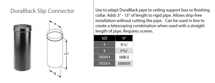

Duravent has short slip sections. To fill a slightly larger than 18" gap you could get a 6" or 12" section and add this slip section.

begreen will that duravent hook up to regular pipe or is that special like what webby is talking about? It does appear to have some funny notches in the end instead of the regular crimped end.
Not sure but it might work. Is the tee snout end crimped? To be sure give M&G a call:
Tel: 800.835.4429
Sometimes the tee snout needs crimped, but single wall usually fits of with a little planning. No matter the brand..
We install 35-40 woodstoves a year, maybe more? and never ever install one without a slip section of pipe. For ease of installation, but more importantly so it can be cleaned properly in the future. Your "local" hearth shop must be more of a hardware store than a hearth shop!

Like I said, Crimp the tee snout. Use a 1' piece of pipe and a slip cut to length. Make sure to screw all the connections together.

Sometimes the tee snout is the same size as your stove pipe, or nearly anyway. If you crimp it then you can insert it into the female end of the connector pipe. You always want the male ends pointing down hill, the way you had it with the double crimped part is incorrect. Gotta pay to play! Or just take it in and have it crimped if needed. Usually doesn't though.
