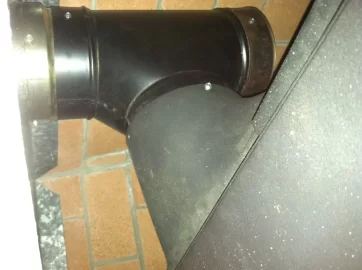

I can't seem to upload a picture with my phone. But it's tee that hooks directly into the back of the stove
[Hearth.com] Temp question. Here is a pic of the tee. That's the only area I can hit with the ir gun. What's a max temp for the tee on a start up
Yes it is single wall attached to about 25 feet or so of flexable liner.
