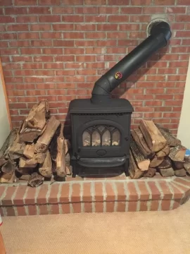

Here is the stove (wood isn't generally stacked there) I put it there while I was moving stuff around and stove wasn't in use) [Hearth.com] Temperature readings...laser, traditional etcand the thermometer. [Hearth.com] Temperature readings...laser, traditional etc

I agree with what was said. Better check the manual that came with the stove. It looks like you may be a bit to close with distance to combustibles dimension.
Behind the stove is brick over cement chimney. Are you talking about the front? I definitely need a hard floor cover or, at the very least, a non combustible half round rug.

You got me chucking. The wood stacked within that distance is a problem. If you get that stove cranking, I wouldn't sleep at night.
Yup . . . I too noticed the wood stacked within inches of the woodstove. Would not be found in my house.
Good lord. Lol.
I said in the initial post AND quoted again after someone mentioned it, the wood was only there as I was moving stuff around the other day. Stove wasn't being used. obviously I wouldn't keep wood there.

Hehheh . . . some of us obviously aren't so good with the whole reading comprehension thing. ;) :)
And yes . . . wood near the stove is bad. Propane is fine. ;) :) Just be sure to make sure you open up the tanks to allow the propane to air out . . . I hear that's helpful to do once in a while. ;)
No worries. I knew the minute I posted that pic people would see it and scold me!

Sorry I missed it in your original post. Just a real dangerous practice we have seen here before.
