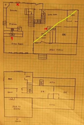

I went ahead and drew up a floorplan of my house fwiw. Not sure if anyone can spot any other opportunities but anyway here it is: [Hearth.com] temporary pellet burner install?
Top floorplan is main level, the one below it is the upper level. Drawn best I could to scale, 1 square = 2 feet. I did forget to draw several windows, that will be on next revision. But all the critical stuff is there.
I crossed out (yellow) the half of the house I was going to shut off for the winter.
In red arrows is my 2 existing woodburners, and red X where I was thinking of the temporary pellet stove through the window in dining area.
The only other spot I could see it possibly go is on the left wall of the great room, but it seems silly to me to put that right within a few feet of my insert. And I don't really want to mess with the insert, and have it functional for burns when its my days off.
Then again this all might be pointless. I'm coming to realize that it would probably be well into heating season until my wife moves out... might not be able to shut that half of the house down.
Ok so I had some discussions with wife. Doesn't sound like she has any interest in whats on the market right now. Not to say something wont pop up tomorrow she likes... but as I said in last post it would be well into heating season I figure before she moves out. If that is the case the whole house will remain open (she uses downstairs bedroom on right side of house for her home office, I use the bathroom next to it as 'my' bathroom and the bedroom above it currently.

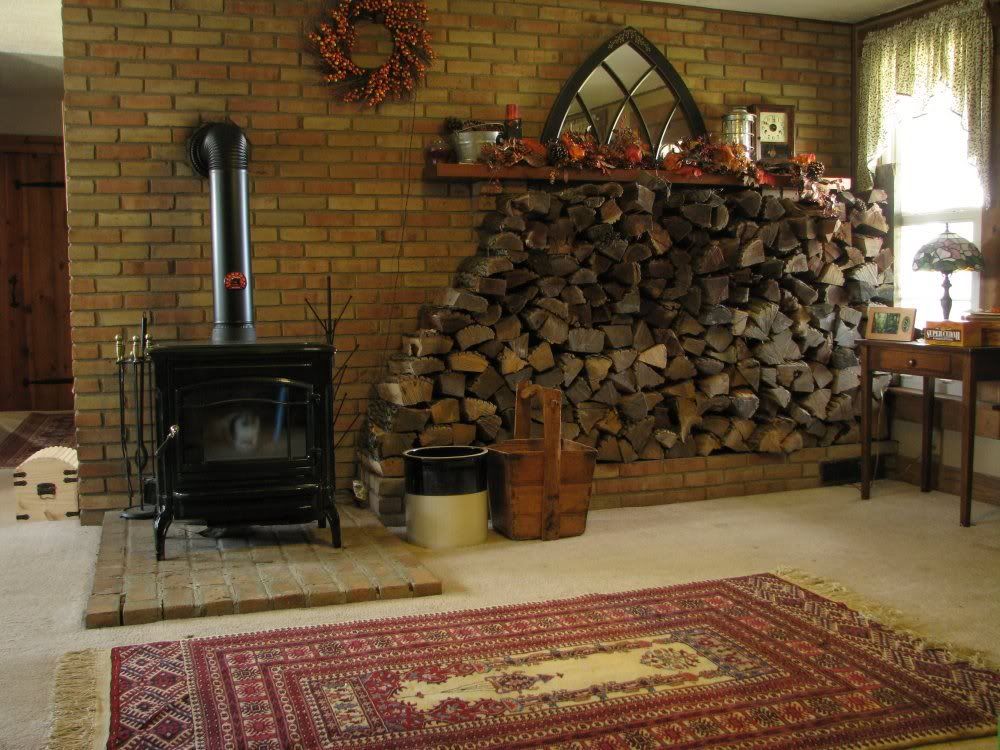

Just for reference here is the stove I'd be replacing and its hearth, etc (Hearthstone Shelburne):
