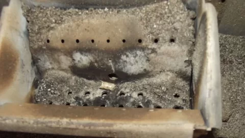

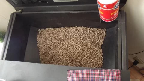

the Pic shows the stove after 14h with the Greene Supreme :eek: it was only 3/4 bag of Greene Supreme i think i will search a person with a pelletstofe that i'm dislike and make him a present of 2 bags ....

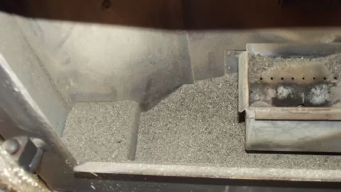

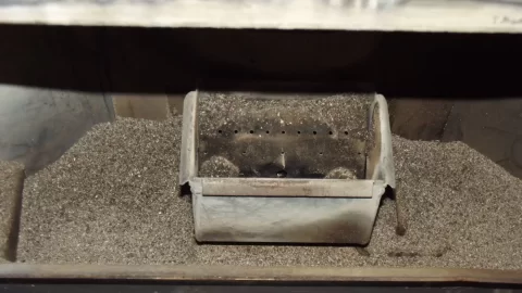

ash that we have with the AMBIANCE after 2-3 Bags. now the stove is clean and filled up with the AMBIANCE well make new pic's next day ....

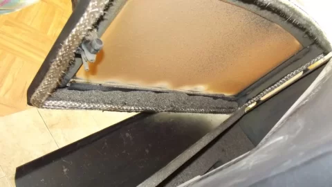

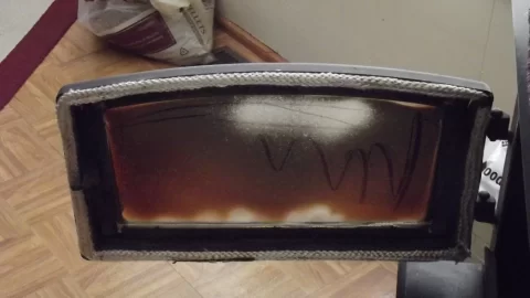

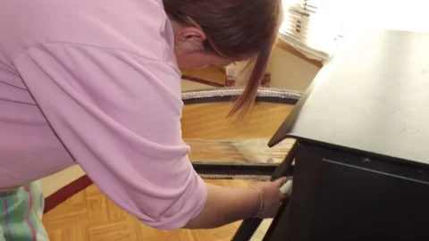

here some pics from today
[Hearth.com] testing diff brand's of pellets[Hearth.com] testing diff brand's of pellets
the glass was 90% cleaner b4 we start the test and b4 we put the new gaskets in :(((
you can't clean the glass with out a chemical oven cleaner :(
what's running wrong now ???
I.m not an expert. and I don't know a thing about your stove , but looking at the pic of how black the glass is looks like the fire needs a little more air.
Don't have your stove either. There was another thread from someone with black glass issues as well that might be worth reading through. https://www.hearth.com/talk/threads/black-glass.101460/ It seems like more of a problem than pellets, even though I personally think NEWP are horrible.
Another thread on your stove that might be helpful https://www.hearth.com/talk/threads/drolet-eco-45-weak-blower.100385/ One of the experts on this site doesn't seem to like your brand of stove, didn't explain why. I see you just got this stove Nov. 2012. Did it ever burn clean? It it never did, less likely it is a cleanliness issue, although burning NEWPs there could be hidden ash somewhere. Sorry can't be very helpful.
Don't have your stove either, however, your pics of the gasket are interesting. I don't see an air wash anywhere which could explain why the glass is so dirty. The pellets as everyone else has been saying are high ash in any stove so I don't see an issue there.
Just looked up specs for stove at northern tool lists an air wash "to keep the glass clean". Wish I could help more.

the old glass gasket was only on the topside from the glass but the manual say complete around.
on the door gasket when the door was closed you can push a postcard in :(

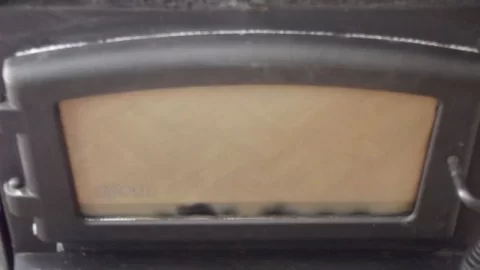

oki we try now in the last days 3 bags of crabbe pellets
very nice heat feels that they burn a lot hotter as the other brands
ash amount is ok
