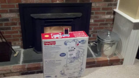

I'm trying to plan on next years stock and am trying to figure out which Pellets I should get and which ones put out the most heat. I have no special equipment so I tried putting a box in front of the pellet stove with a thermostat on top of it and set the stove to 2/3 setting. I tried testing with 3 separate pellets. All the variables the same. The ONLY difference was the temperature outside. There are people here who are much smarter than me so I wanted your opinion as to weather this is a good test as to how much heat the pellets put out. It's not perfect but I'm looking to gauge what pellets put out the most heat so I can purchase a bunch for this year and next. I have attached a pic but basically what I did was put the box you see in front of the stove, same distance from the stove, same setting on stove, door closed everything was identical and I started the clock. I put the box in front of the stove with the thermostat on it after the stove had been running all day and waited 20 minutes and then looked to see what the temperature was reading after 20 minutes. Here are the results. Are these results valid at all using this method?
Maine's Choice - 90 degrees after 20 minutes
LaCretes's - 97 degrees after 20 minutes
Lignetics - 106 degrees after 20 minutes ( as a note the lack of ash on these pellets is amazing!)
Do these number mean anything or did I just waste my time. [Hearth.com] Testing the heat output on Pellets - Would this work - opinions?
I would think that outside temperature and humidity would have a big effect on your results. Did you record either of those things when you ran the test?

md2002....Your test, although seemingly purposeful, is somewhat flawed. The outside temps will play a significant role in the reflected temp on your device. But moreover, your assumption is that if you burn all three pellets on the same feedrate setting, that you will be feeding all three brands at the same rate. You will not, and here is why. Pellet length will play a major role in how quickly your pellets will feed. You see, a long pellet will feed at a slower rate than a short pellet will. Shorter pellets will "pack-in" to your auger housing tighter than long pellets will, and the result is that every time your auger turns, you will be feeding more pellets per hour. Here is a great experiment....Take a one quart mason jar and fill it with a brand of pellets that are longer in lenght, and weigh the jar. Then, take the same jar and fill it with short pellets and weigh it, and the short pellets will actuall mass out higher than the long ones.

With the thermometer that close, wouldn't the plastic casing around the thermometer just soak up the heat and radiate it back on itself, giving you a false value?

I do not have an OAK on the system. The humidity was 1 - 2 % difference so that was irrelevant. The temps outside were very different one (MC) was tested when it was 30 degrees outside, one (Lacretes) was tested when it was about 4 degrees outside and the Lignetics were tested when it was 50 degrees outside. I knew this probably wasn't a good measurement but I had to try, and ask.
The length is a big difference as well. The Lacretes are MUCH shorter than the other 2 pellets.I tried.
