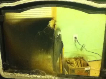

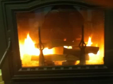

The other day I was cleaning my stove glass and all I could think was how stupid it was that everything I try just leaves a residue that turns black immediately. So on the forum somewhere I read that I could just use ash and hot water which would clean it right up ( I thought ya right that will work )! Well here is the proof it works as well as a nice cold start >:( I hate cold starts )

Why is the glass so nasty, is this typical of this style stove? I've never even sooted up the BK glass that bad.
If I burn wood it stays very clean however I am sing Eco blocks right now and they do not form a hot enouph coal bed to keep it clean all the time. The Eco blocks burn hot but they tend to leave clumpy coal bed for a while. I usually mix wood to keep it hot but it has been so warm that I am getting by just fine on Eco blocks for now.

My other problem was the cleaner I used kept leaving a film behind so when I fired up the stove it would flash burn and go instantly black. This is very anoying considering it is wood stove glass cleaner :exclaim:
