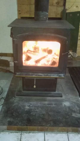

I originally joined the forum to get help fixing my stove because I could not clean the upper EPA baffle. I have since broken the glass on the stove doing something stupid, so, I am thinking about replacing the stove if the glass can not quickly and easily be fixed.
Though the main problem has been the last 1.5 years is the upper baffle is clogged, it appears to be welded in, and I have not been able to clean it with flue cleaning powder, rods, blower, or a vacuum cleaner from the flue side. Blowing air from the chimney side to the baffle/firebox solved nothing. The air no longer goes into the baffle holes and just rolls out the front if the flue is closed, which can kill the fire. Which has meant keeping the door ajar or the flue open.
Now the flue control handle has lost it's "spring" and falls down open.
It needs new firebricks, I replaced a few last season, but, it needs a whole new set.
I broke the glass doing something stupid, so, it needs a new glass, I do not know where to buy it except places on line list a 4+ week wait. I guess there is a difference in glass too.
The baffle being clogged is the biggest issue, besides that I have been happy with the Drolet NG1800 Myraid.
