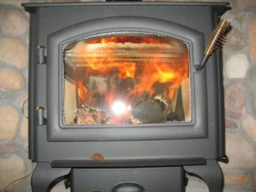

Ok heres a quick test.
I loaded it up with oak, ran full air to about 650. ( could have maybe made 700 with one more piece but didnt want to open doors etc. ) maintained that for about 5-10 min then shut off all air. dropped to about 500 in less then 30 min and held. here is a pic at 600.

Nice stove! Excellent picture too. You have proven that my stove is leaking more air than it should. My air controls have been closed now for about an hour and I am still at 650.
