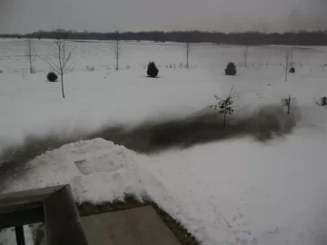

I've used the old leaf blower quite a few times, and never noticed any ash laying around after I did it, except for a little bit on top of the snow. My stove exhaust is on the side of the house, so that is why I noticed a bit on the snow. I don't think you'd see any if you have to do it from the roof. It really is amazing what comes out of that stove pipe!

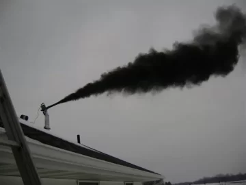

yes you could see some if your doing it from the roof.
These two pix are the best advertising for the "leaf blower trick"...
Pic are worth a 1000 words!
You know I just finished reading an article about how low the particle emissions are on pellet stoves. I suspect that if one were to include an annual leaf blower style cleaning in those calculations then the pellet stove may lose ground to coal burning for being a clean heat technology based on those pictures!
